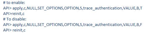

    Did you add & approved the privileged client for your app server for D2 from DA? if so, enable the authentication trace from docbase end using api and check the docbase log for more detail.
    to enable:
    API> apply,c,NULL,SET_OPTIONS,OPTION,S,trace_authentication,VALUE,B,T
    API>reinit,c
    To disable:
    API> apply,c,NULL,SET_OPTIONS,OPTION,S,trace_authentication,VALUE,B,F
    API> reinit,c
